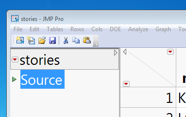

The original question also asked about using a folder name from the XML data. That folder contains a CSV file with the actual data. The folder name is in a column with a name like Infoes.Name. The dotted name represents a nested path in the XML tree. You can use that to open a file in the folder.
I recommend using the text import peview to create a source script that you can copy from the imported table. The script will look something like this (use right-click->edit  on source to get a copy):
Text import preview source scriptText import preview source script
