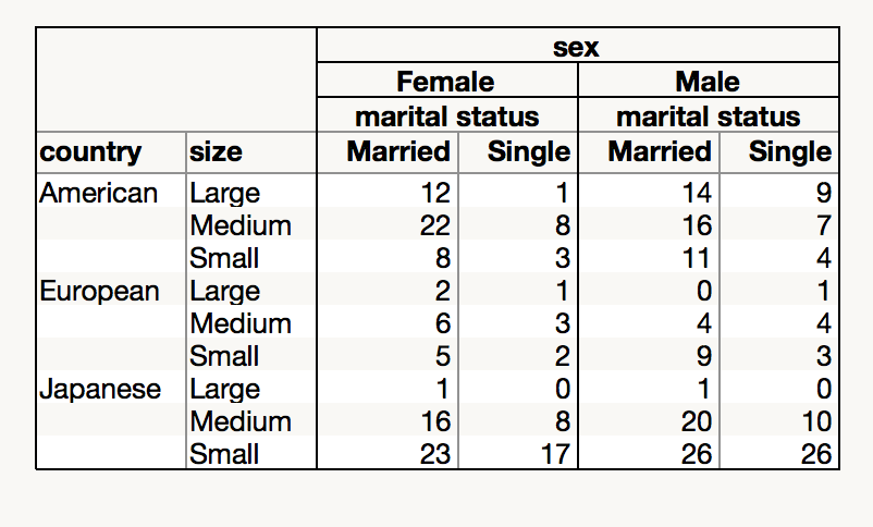

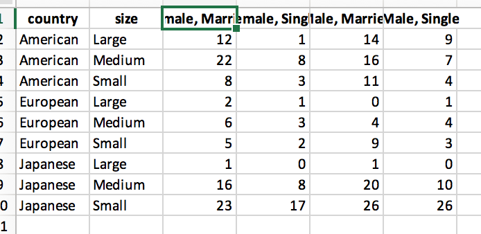

Thank you for the reply.
However with the script you provide the output looks like the below, first screenshot; while I'm looking to output the table in the second screenshot.
Thanks,
Joann

That would require the generation of a full Excel formatted file, since it includes spanning columns, etc.
Jim

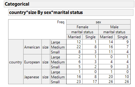

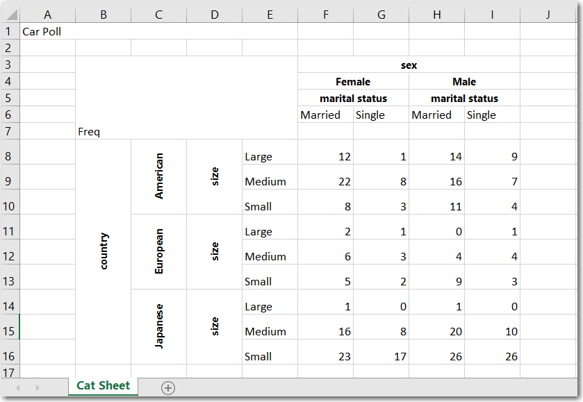

Since you did not specify, which summary statistics that you are using or your JMP version, this might not work for you. If your JMP includes the Categorical platform, and you can create your tabulate table using Categorical, there is an option to Save Excel File(). An example script, the JMP output and the Excel file are displayed below.  The shading is not saved, and if labels are long they are rotated, but the structure remains.
This is just an FYI for a possible alternative.  I have not used Categorical much, I know N, Means, Std Dev, % Response are available. However, I have not investigated quantiles and other statistics.
Names default to here(1);
dt = Open( "$SAMPLE_DATA/Car Poll.jmp" );
obj = dt << Categorical(
	Structured( :sex * :marital status, :country * :size ),
	Share Of Responses( 0 ),
	Share Chart( 0 ),
	Legend( 0 ),
	Total Responses( 0 )
obj << Save Excel File(
	"c:/temp/jmp_to_excel_categorical.xlsx",
	Separate Rows for Each Cell Statistic( 0 )
JMP Categorical ReportJMP Categorical ReportSaved Excel FileSaved Excel File
