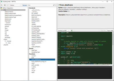

jthi
Re: issues running jmp2pandas.py
I would suggest using more modern methods to go from dataframe to datatable as you have JMP19 (jmp.from_dataframe)
View more...
import jmp
import jmputils
try:
    # pandas depends on numpy will install numpy if needed
    if not jmputils.is_installed('pandas'):
        jmputils.jpip('install', 'pandas', echo=False)
except Exception as e:
    print(f'Install failed with exception: {e}')
import pandas as pd
import numpy as np
pandas_df = pd.DataFrame(
        "A": 1.0,
        "B": pd.Timestamp("20130102"),
        "C": pd.Series(1, index=list(range(4)), dtype="float32"),
        "D": np.array([3] * 4, dtype="int32"),
        "E": pd.Categorical(["test", "train", "test", "train"]),
        "F": "foo",
print(pandas_df)
dt = jmp.from_dataframe(pandas_df)
print(dt)
See Scripting Index
Going further with Python in JMP 19
-Jarmo

jthi
Agreed!
I guess @mhw_novonesis was using this reference: Creating a Pandas DataFrame from a JMP Data Table, but now there is the new function (as of JMP 19): jmp.from_dataframe()
