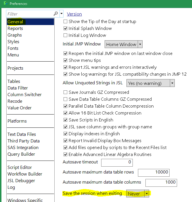

Not sure, I think it might be this preference, which I think is easy to accidentally turn on when a new copy of JMP is installed.
I try to never turn it on because it prevents JMP from starting fresh each time.
(save session should be never, not always)
Craige

hi Craige_Hales,
I was able to fix the issue with me script, thank to your post.
the problem is not what you describe, but simply the fact that my JMP version present on win7 as a French language selected instead of English like it's on my win10 machine.
thank you to take time to answer to my post and also to fix it.
Regards
