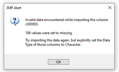

I also open data with using preview, It solved the problem without pushing any other change but I received this message, and since the data set has more tha 1 mil, rows, I am still not sure if the data transfers properly.
Random check however looks ok with data as continuous and decimals

The alert dialog means JMP found values in a numeric column that could not be converted to numbers. It replaced the value with a missing value. It continued on after that, so the rest of your data should be okay. The suggestion about converting the column to character is just so you could investigate what the odd value was.

Thanks, cammas are decimals in source data, the visual investigation is not a good solution to find odd values in such a big number of raws (15478), I prefer having 186 missing values... however this is a subset of much larger data, so 186 leave out from a sample can be much more in the big data without knowing the reason is not a safe situation, thats why I am looking for a proper import of csv files into JMP, I think I do not know all tips and tricks here in transfering data from csv to JMP
