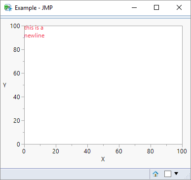

I think you just want to change your coordinates. So, change {50, 20} to the {x, y} position you want. The x will be the position of the left side of text and the y will be the bottom of the text. The update code below will put the text all the way up in the upper left corner, touching the borders of the graph box.
a="this is a \!nnewline";
Names Default To Here( 1 );
New Window( "Example",
	Graph Box(
		Text Color( "red" );
		Text( Erased, {0, 90}, a );

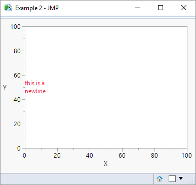

Re: is it possible to keep text left and top position?
Interesting. When I run the code with coordinates set to {0, 90} this is my output:
coordinates {0, 90}coordinates {0, 90}
It only shows in the middle if I set my coordinates to {0, 45}:
coordinates {0, 45}coordinates {0, 45}

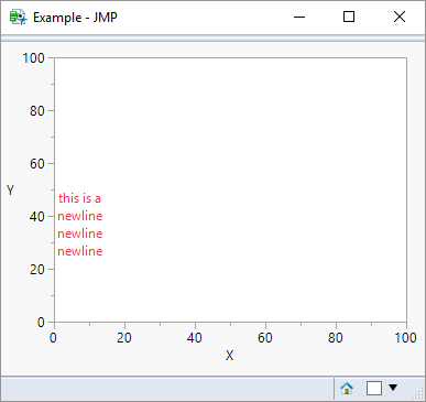

a="this is a \!nnewline \!nnewline \!nnewline";
	Graph Box(
		Text( Erased, {0, 50}, a );
e.g in this pic and JSL. i set y cordinate 50 but my text is centered to 50. but what i want it to start from 50 and go down. Any solution
Oh, I see. Sorry, I misunderstood. You need to use the {left, top, right, bottom} coordinates. It shows under Example 2 in the Scripting Index for Text. Essentially what it does is create a box with lines at the specified coordinates which your text will be placed in. If you make the "right" coordinate too small it will cut off the text. As you make it larger, the box expands, which will start to move the text over as well. I'm not sure if there is an easy way to just specify top and left numbers without the others.
