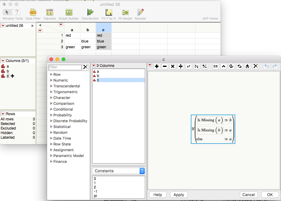

I would create a new column with a formula using If() to test each of your column for missing (use the Is Missing() function) and put the value of the other column into this new column.
The formula would look something like this:
-Jeff
-Jeff
