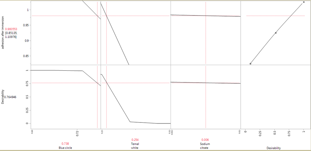

it is a cementitious formulation. one of the most important reponse is adhesion after water immersion.  I want to optimize the adhesion,  it needs to be above 1MPa.
Below is the profiler generated by JMP with maximizing desirability.  adhesion after water immersion is 0.98 MPa which is not good enough to meet 1 MPa.
By manully change the propotion of three factors,  profiler show below results, with adhesion after water immersion around 1.02 MPa.
So my question is what is the procedure of optimization with profiler?  Do we relay on desirability function or we have to manully adjust the level of factors?
what if the desirability function fails to meet the target?

I can tell there is a strong interaction because the effect of Sodium Citrate was null to begin with in the Prediction Profiler and then a large change in the Blue Circle level caused a large effect of Sodium Citrate. The same is true for the other factor.
Model selection is a careful process that requires all of the knowledge available. I notice from the labelling in the Parameter Estimates report that JMP is not using coded factor levels, which centers the variables. Regressing the uncoded factor levels can dramatically reduce the power of the hypothesis tests about the estimates against zero. The coding should automatically take place if you designed the experiment in JMP and retained the data table with all of the meta-data. Fit Least Squares responds to the Coding column property that was added by the JMP design platform when you clicked Make Table. Coding will help the significance of some terms. It can't hurt.

Are the three factors entered as mixture, continuous, or discrete numeric factors?
You appear to have a strong interaction between the blue circle and sodium citrate. That condition might lead to a local maxima. Changing the initial factor levels and repeating the optimization might lead to another maxima.
The numerical solver behind the optimization of the desirability function has settings that you can change when necessary. The settings dialog box is available through the red triangle menu.
See Help > Books > Profilers.

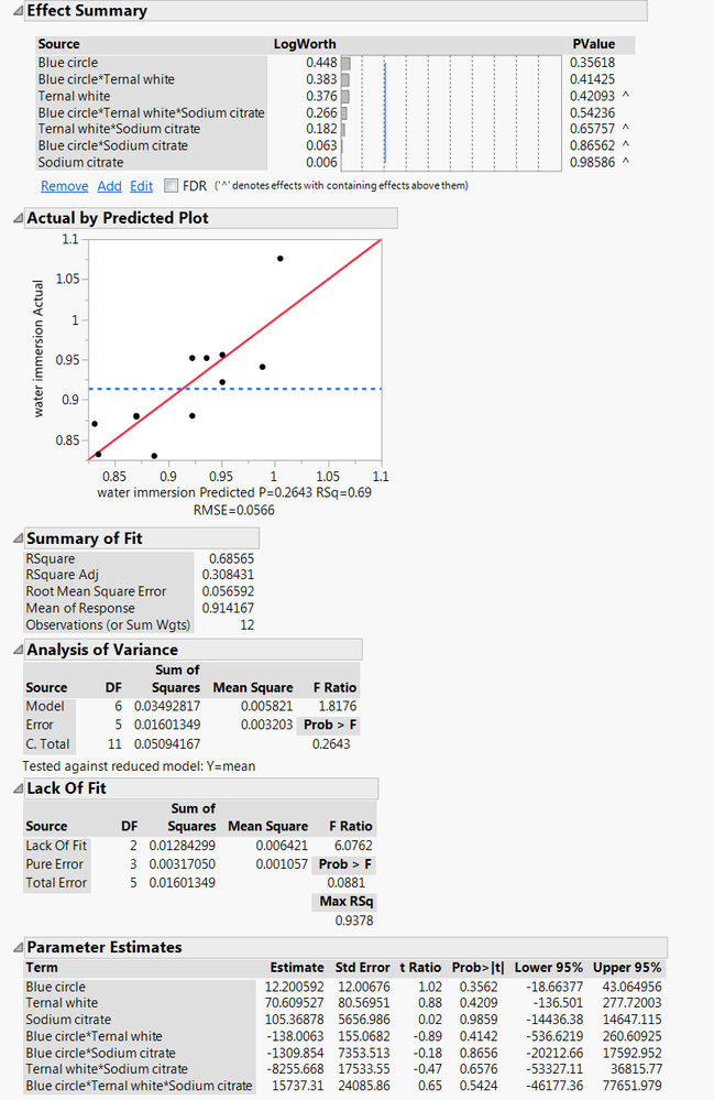

How can you tell that blue circle has strong interaction with retarder sodium citrate? since all the P-value is all bigger than 0.05.
Beside the profiler optimization, the task of finding the most significant factors also puzzles me. see below JMP report.
What information I can relay on for significance of three factors and their intercation?
What else about model selection or model reduction puzzles you?
