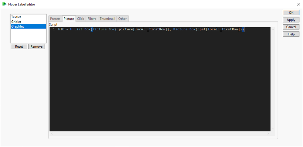

jthi
Re: image in a label
I usually either create new column which combines them into single image and use that or hover labels. Below is hover label example (it does require some scripting)

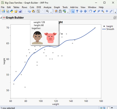

txnelson
I am not aware of a way to do this in JMP directly.  However, you can create a new column that has both images joined together and then use that as your label column.
Here is a simple example:

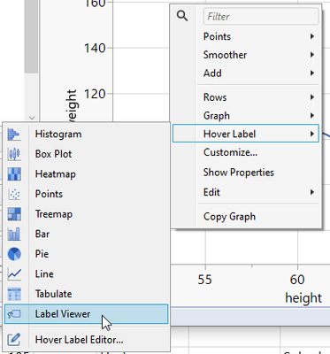

hogi
Level XIII
If you have Jmp16 or above, you can use Hover Label / Label Viewer to enable Graph builder to show more than a single picture as label:

jthi

txnelson

hogi
Level XIII
