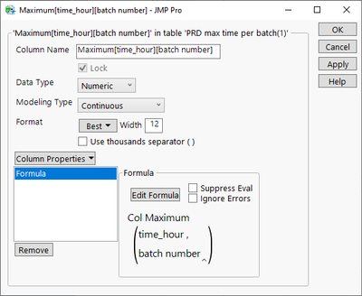

Col Max( :time_hour, :batch number )
Jim

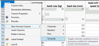

Right click on the column header which you wish to use for grouping (batch number) and go to New Formula Column and select Group By

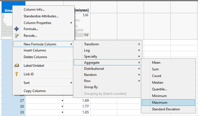

Next right click on the column header which you wish to perform the calculation from (time_hour) and New Formula Column / Aggregate / Maximum (note that there is Group By [batch number])
This will create you a new formula column
