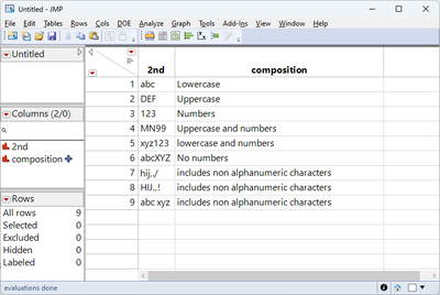

If anyone else needs a handy example try the following:
If(
	Regex( :"2nd"n, "^[A-Z]+$" ) == :"2nd"n, "Uppercase",
	Regex( :"2nd"n, "^[a-z]+$" ) == :"2nd"n, "Lowercase",
	Regex( :"2nd"n, "^[0-9]+$" ) == :"2nd"n, "Numbers",
	Regex( :"2nd"n, "^[A-Z0-9]+$" ) == :"2nd"n, "Uppercase and numbers",
	Regex( :"2nd"n, "^[a-z0-9]+$" ) == :"2nd"n, "lowercase and numbers",
	Regex( :"2nd"n, "^[A-Za-z]+$" ) == :"2nd"n, "No numbers",
	Regex( :"2nd"n, "^[A-Za-z0-9]+$" ) == :"2nd"n, "All characters",
	Regex( :"2nd"n, "^[A-Za-z0-9]+$" ) != :"2nd"n,
		"includes non alphanumeric characters"
