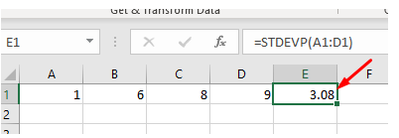

I tried to use the same function as STDEVP in Excel and I didn't find an exact analog in JMP where I could receive the same result.
For example, if I will take four numeric numbers as well as 1,6,8,9, the STDEV should be 3.08
but if I'm using formula SDT DEV in JMP I'm receiving result of 3.56
I will appreciate it if you could direct me to the right place in the formula where I can receive the same result of 3.08?

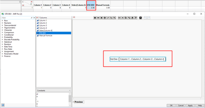

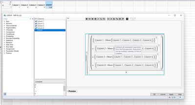

You have two different values because the formula behind are not exactly the same :
  • When calculating the standard deviation for a population, you divide the sum of square of the differences between mean and value by the total number of values N, in your case 4, before taking the root square. You then find 3,08 (see formula attached).
  • When calculating the standard deviation for a sample (a part of the population), the denominator changes and you have N-1 instead of N (see formula StdDev_Sample attached), as you use 1 degree of freedom from a fixed sample to produce an estimate of the sample mean. It is known as Bessel's correction. You then have the value 3,56 proposed by JMP.
You can have a look at the comparisons and calculations in the JMP file provided and statistical details here : Explanation of Summary Statistics (jmp.com)
Hope it will help you,

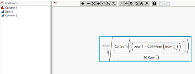

Here is the formula you can use with a column named "Values" containing your data. You will only need the individual values for your observations in this column (the number of rows is automatically calculated with the function "N Row()") :
Root( Col Sum( (:Values - Col Mean( :Values )) ^ 2 ) / N Row() )
If your column is named differently, just change the ":Values" with ":Name" (Name being the name of your column).
Hope this will help you,
Victor GUILLER
