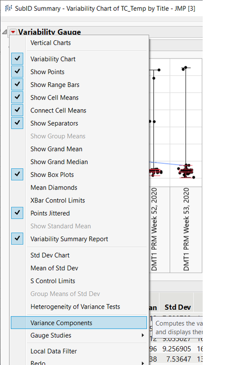

 I think you can use Variability plot and then select "Variance Components"

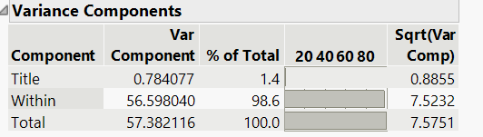

the final report would look like this:
So give it a try!

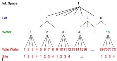

There are 2 approaches to estimate variance components.  Assuming your sampling plan is nested (hierarchical) and may look like:
You may use the control chart method to analyze the data.  This would start at the within wafer layer with a range chart to determine within wafer consistency (if it is stable and consistent, estimate the variance by Vww = (Rbar/d2)^2) and then compare the within wafer to the other components in the study with an Xbar chart (the control limits are a function of the within wafer variability)...if the Xbar it out-of-control, then "roll up the tree" by summarizing the within wafer data, and creating a new subgroup based on wafer-to-wafer variation, etc.  This will allow for both assessing consistency and estimating variance components.
