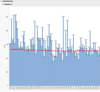

Hi Community,
As I'm a new user i struggle to get familiar with all the functions.
Is it possible to add a mean line calculated from JMP in a distribution histogram ?? (attached an illustration of what i would like)
Anyone that can help ??
Thanks

Re: Add mean to distribution histogram ?
Your example looks like the x-axis is nominal, which means you actually have a bar chart, not a histogram.
In that case, the mean is the total number of observations divided by the number of categories. You can add a reference line and for the value, enter that number.
If this truly is a histogram, then you want the reference line that is the average number of counts in each bar? That would change depending on how many bars you would like to have, which is changed easily using the grabber tool. It becomes a bit more difficult to add your line then.
Maybe a more specific example or clarification of what is being graphed would be in order. You should also probably consider graph builder rather than Distributions.

Thanks Dan for your support.
I was checking and the x-axis data is nominal. It a machine number.
The Y-axis shown is also nominal. it is the grand total sum of working hour we use for assembly of machines.
the distribution shows me the spread in hours, but i would like for simple visualization, to add the average hours used  for the sum of machines.
The benchmark line I could add manually as this will not move, but the average could move if I add data.
Maybe graph builder is a better choice?

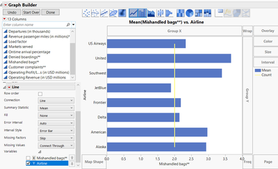

Hello,
I am following the steps to get a line added to my bar graph for my x variables. When I add it, the line is a count. Any advice?
Thanks,
Rebecca
@Dan_Obermiller  Thanks in advance!! :)
txnelson
You have chosen to base the line on the Airline variable. No Y variable is in your selection, therefore, the only thing it has to calculate is the count. If you select both Airline and Mishandled Bags, you will get the mean bags mishandled for each airline
