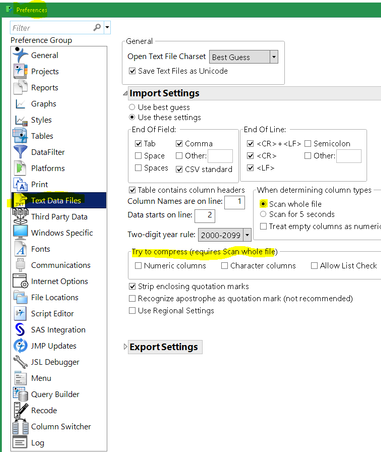

Can you import a csv file and apply the compression initially before already importing it into memory?
Craige_Hales
Re: how to optimize the cpu/memory usage in jmp on Windows
CSV import does have the column compression as an option (off by default):
It will choose the best of several alternatives after scanning the data.It will choose the best of several alternatives after scanning the data.
JMP has two kinds of compression for data tables. This one is the column compression and works by noticing a limited set of distinct values and using one of JMP's alternate column formats. This will make the in-memory footprint smaller.
The other kind of compression uses a zip-like mechanism to compress columns. This can be slow to open and even slower to save, and offers no in-memory benefit...only on disk. It is on the red triangle, something like compress when saved. Particularly helpful for huge tables of repeating values.
Both can be used together.
