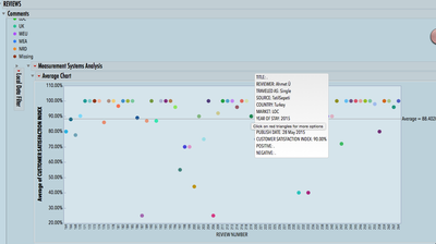

This time I use Fit Y by X or MSA and by labeling the rows I can share the row data as the user hovers his mouse over any point on the graph.

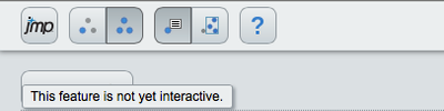

Using panel box ends this beautiful opportunity (inside panel box the tool box is not working) but I still need local data filter for each graph.

No panel box used and the user can get the data beautifully;

Inside panel box the tool box function goes off and "this feature is not yet interactive" comes which makes the tool box end;
