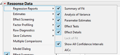

Hi @aczura : Perhaps here (pull down menu via red triangle next to response name at top of output)?

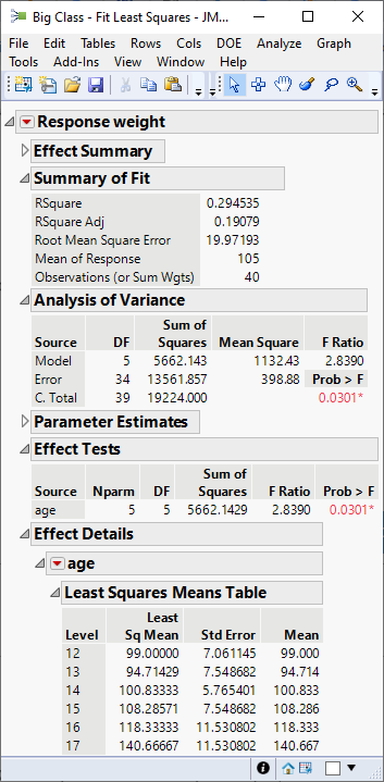

Here is an example, :weight versus :age from Big Class sample data.
The Effect Tests table is the one you are looking for. It is based on Type III Sum of Squares.
