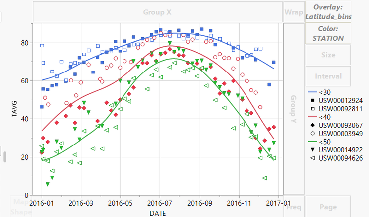

how to generate this graph in Graph Builder?
How to generate a plot in Graph Builder with:
  • color & fit  = Latitude bin
  • marker = Station
like this one:

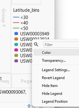

The plot doesn't look fancy, but most JMP uses will get stuck when they try to adjust the markers.
STATION is used as Color - and "therefore" the user is only allowed to change the color:
Sure, everybody knows a JMP expert - and they will help with a  workaround [what is your favorite one?].
But, Why is this DropZone called "Color" , and why is there no Marker Dropzone when I need one.
Why is it not possible to generate such a simple plot without expert skills?
... why is it not possibility to adjust the Marker, the way the user expects:
