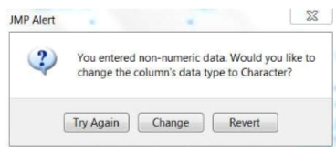

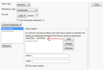

Thanks for the suggestion, but didn't seem to make it work. Please see the attachment where I added WAITING = WAITING rule and still could not enter the text WAITING in the continuous column.
Got the following message when I entered WAITING in a cell of the ‘Continuous’ column:

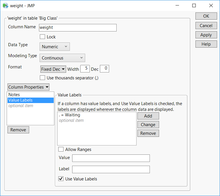

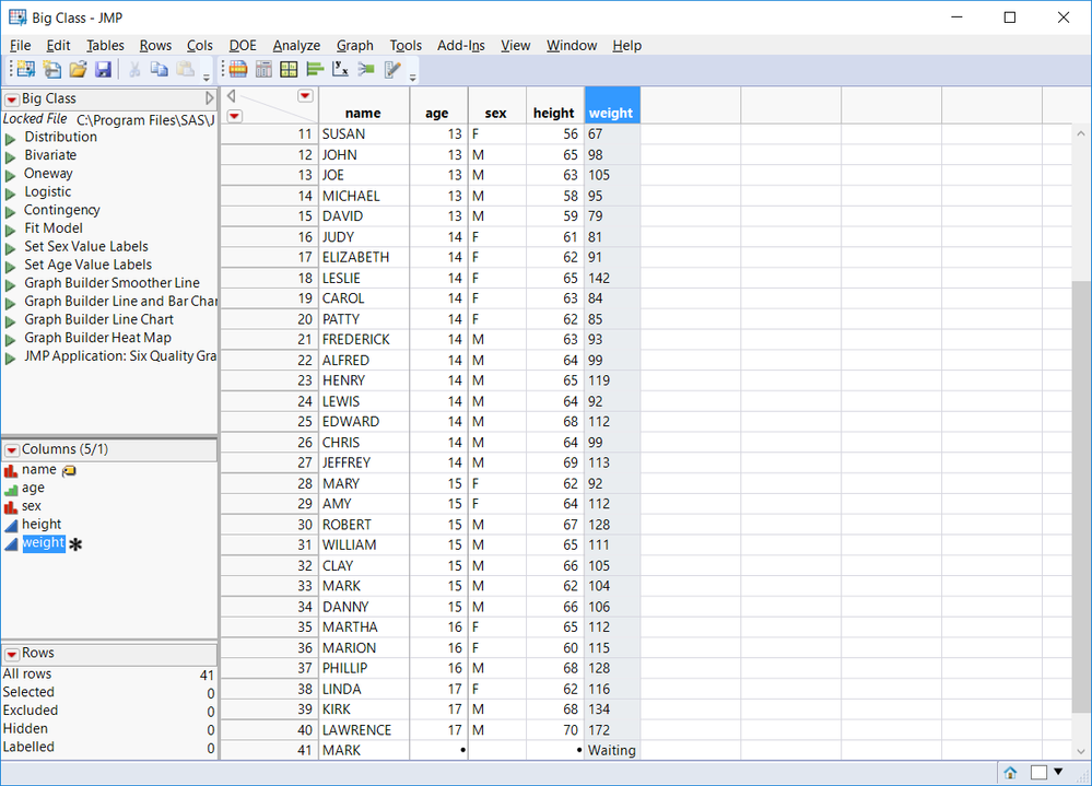

Re: how to enter both text (character) and numeric (continuous) data in the same coloumn in JMP 13.2
Enter a period (".") character (without double quotation marks) as the value to represent missing and "WAITING" for the label.
The values now appear as text in the data column (left justified) but they still had the numeric data type and the continuous modeling type.
