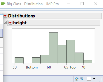

There is not a way to change the Segment Label for the builtin LSL, Target and USL display for the histogram.  However, you can specify to not display any of the spec limits, and then add your own Reference Lines where you can specify any labeling you want.  The difference is that the label will be on the axis side of the graph.
Names Default To Here( 1 );
Open( "$SAMPLE_DATA/Big Class.jmp" );
Dis = Distribution(
	Continuous Distribution( Column( :height ),
	Horizontal Layout( 1 ), Vertical( 0 ) ),
	Histograms Only
Report( Dis )[Axis Box( 1 )] << Add Ref Line( 55, "Solid", "Black", "Bottom", 1 );
Report( Dis )[Axis Box( 1 )] << Add Ref Line( 67, "Solid", "Black", "Top", 1 );
Report( Dis )[Frame Box( 1 )] << Reference Line Order( 3 );

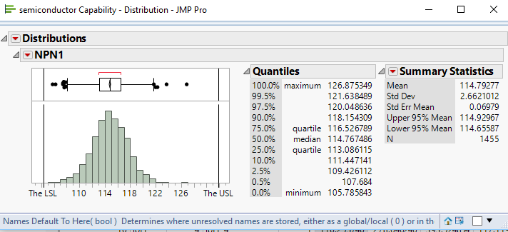

Below is a simple script that generates the following display
dt = Open( "$SAMPLE_DATA\semiconductor Capability.jmp" );
dis = Distribution(
	Continuous Distribution( Column( :NPN1 ),
	Vertical( 0 ) )
dis << Capability Analysis( 0 );
specs = dt:npn1 << get property( "spec limits" );
Report( dis )[Axis Box( 1 )] << Add Ref Line( specs["LSL"], "Solid", Black, "The LSL", 1 );
Report( dis )[Axis Box( 1 )] << Add Ref Line( specs["USL"], "Solid", Black, "The USL", 1 );
Jim
