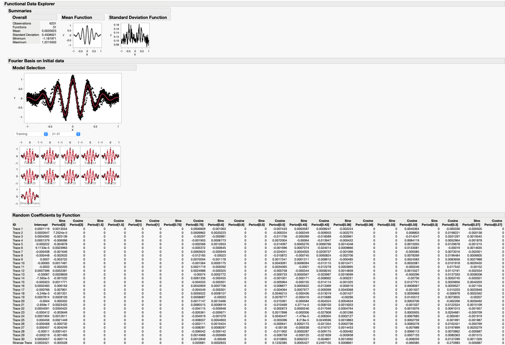

Here is an idea that uses Functional Data Explorer in JMP Pro.  FDE can do Fourier decomposition in a easy way, and you can look at the Fourier basis coefficients to see if any of them look unusual compared to the rest.

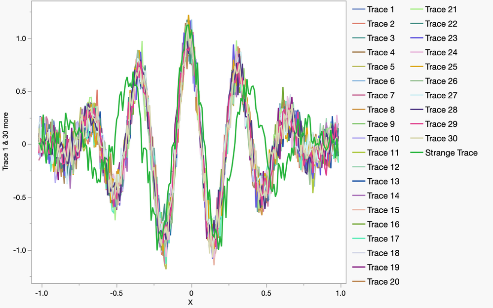

// create some signal traces, with one trace that is different from the others
ntraces = 30;
npoints = 100;
points = (-1 :: 1 :: .01)`;
npoints = N Rows( points );
noise = 0.1;
traces = [];
For( ii = 1, ii <= ntraces, ii++,
	trace = Cos( 2 * Pi() * 3 * points ) :* Exp( -Pi() * points ^ 2 )
	+J( npoints, 1, Random Normal( 0, noise ) );
	traces = traces || trace;
strangetrace = Cos( 2 * Pi() * 2.5 * points ) :* Exp( -Pi() * points ^ 2 )+J( npoints, 1, Random Normal( 0, noise ) );
traces = traces || strangetrace;

// graph the traces
dt << Graph Builder(

// use FDE to find Fourier Basis Functions and Coefficients for Each Trace and save to a data table
Local( {obj},
	obj = dt <<
	Functional Data Explorer(
		Data Format( Column ),

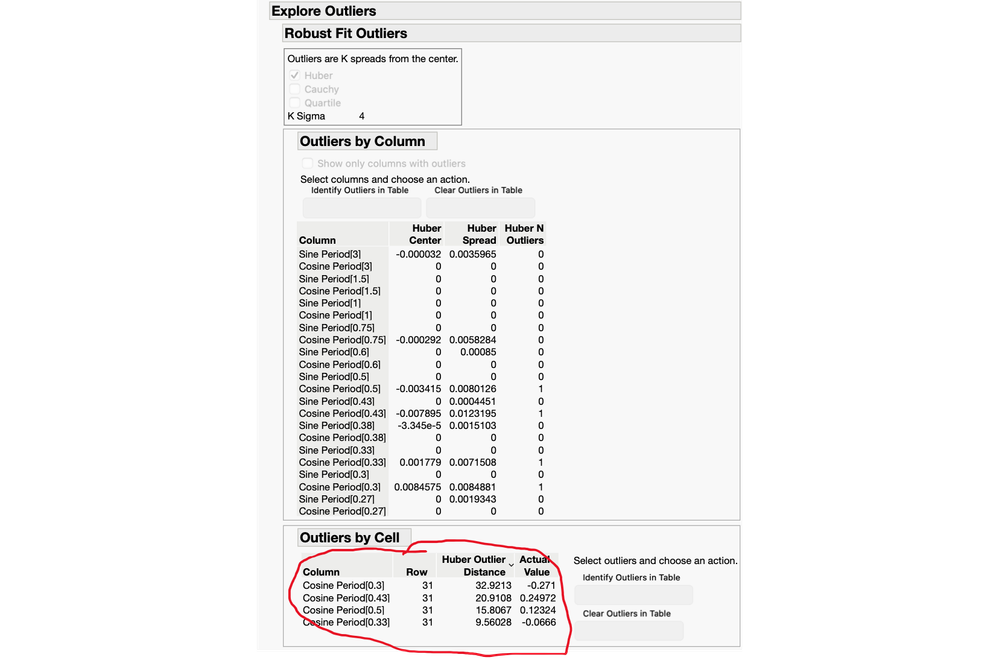

// use explore outlier screening platform to find traces with outlying basis function coefficients
// note, this last step is specific to this problem, other problems might use more or less fourier basis
// functions, but the same general approach using Explore Outlier (Analyze > Screening > Explore Outliers)
// shoudl work fine
outdt << Explore Outliers(

Example graph of generated traces (with added noise, one of the traces is different than all the others)
FDE output (summarized)
Explore Outliers detects the "Strange Trace" (Row 31) based on it's Fourier Basis coefficients
