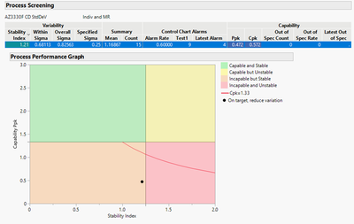

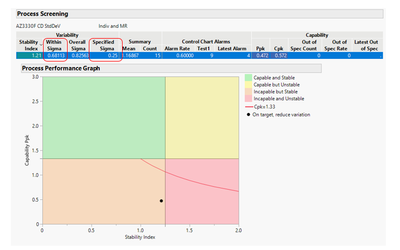

Hello,
I am trying to plot control charts for various process parameters. My data is a monitoring data where I get one data point for each parameter every week. The parameter shown here is the std dev measurement from the monitor wafer. I am trying to plot these std dev. data points from multiple weeks into an IMR chart. I was trying to use JMP process screening platform to be able to short list among 100s of other parameters. The problem I am having is that when I use process screening summary, the stability index is showing as 1.21 (green). When I select the parameter and plot control chart for the selected item, the control chart shows a stability index of 3.302531.

  1. Process screening summary

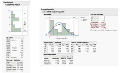

  2. Distributions & Process Capability

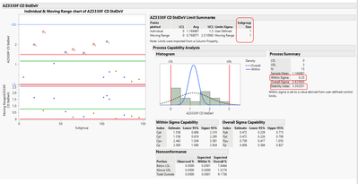

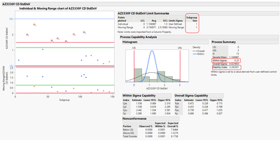

  3. IMR control chart --> Discrepancy for within sigma seen here. My sub group size is 1 and I have locked in the control limits. There is a note on the control chart that says "Within Sigma is set to a value derived from user-defined control limits".

I may not understand exactly what the problem is, but for using a Moving Range chart (IR), the Range Span (surrogate subgroup size) should be 2.

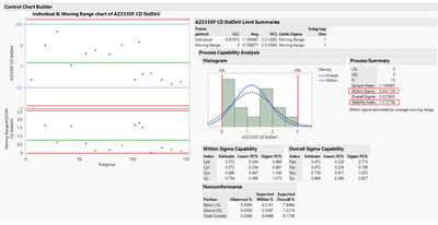

When I removed the user defined control limits from column properties, now I see the "Within Sigma" in the IMR control chart matching to the "Within sigma" on the process screening platform.
My question is what is the best chart I should use with user defined control limits on the data I have (similar to the file attached in my previous post)? I have 100s of parameters in the manufacturing line similar to this. I hoped to use the process performance graph to shortlist only specific processes that fall in the yellow, red & orange quadrants.
We are trying to operate the process in the control limits defined below. And the stability index shown on the control chart is 3.3 which should be in the red quadrant on the process performance graph for the Ppk listed below. But process performance graph shows this parameter in the orange quadrant.
Just trying to find out what are my best options to use this sort of individual measurements on the process screening platform so that I can consistently filter out good processes and just focus on unstable processes for charting purposes?
