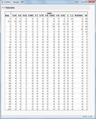

Try the stack command.
Click Tables > Stack.
Select the columns .54 through Plateau, and click Stack Columns
Click OK
In the resulting stacked table, do a tabulation
Click on Tables > Tabulate (JMP 10, 9, 8), or Analyze > Tabulate
Drag Data to the drop zone for rows
Right click on the word Data and select Use as Grouping column
Drag Label on top of N
Drag All on top of Label
This will show individual counts as well as the total.
pmroz
Re: how many times a text/number appears in several columns
Just rereading your post - instead of stacking columns .54 through PLATEAU, only stack columns .76 through 1.

KarenC
Super User (Alumni)
Is this what you are looking for?

I added a column called "Row" to your table, under "column info" I used the "Initial Data" to put in the sequence 1 to 22.  Then I followed Peter's lead and stacked the columns of interest (0.75 to 1) keeping the "Row" column.  Finally, I changed the "Data" column in the stacked table to nominal and used tabulate to get the counts.  So row 1 has 6 "1"s, row 2 had 4 "1s", 1 "3", and 1 "4".
