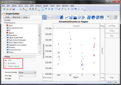

There are many jittering options in Graph Builder now which should allow you to get the dot plots that you desire.

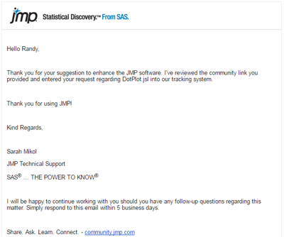

Thanks again for the JMP Support redirect, Jim.
They already responded.
