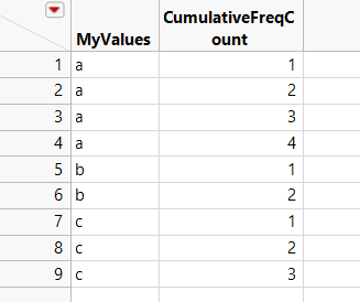

Here is a column formula method:
// define values
Col1Vals = {"a","a","a","a","b","b","c","c","c"};
dt = New Table();
dt << New Column("MyValues",Character,Nominal,<< Set Values(Col1Vals));
// Create Cumulative Frequencies
dt << New Column("CumulativeFreqCount",Numeric,Continuous);
dt:CumulativeFreqCount << Set Each Value(
If(
	Row() == 1, 1,
	:MyValues == Lag( :MyValues, 1 ), Lag(:CumulativeFreqCount, 1 ) + 1,
	1
)); // end set each value
