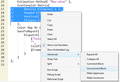

I wholeheartedly disagree.  While not perfect, it for sure is better than Notepad++, now if we were talking Sublime Text that's another story .  There are a lot of helpful tools in the JSL editor.  You can do a split view to make editing easier.  It has a built in Reformat Script to make everyone's code look the same and follow a standard set of rules (although I wish I had more control of what rules to follow).  Hovering over functions or commands will display a tool tip telling you the parameters of the function and what it does.  If you can't remember the full name of a function typing a few words and pressing Ctrl+Space will bring up a list of possible functions you are looking for.  Probably the biggest problem is there isn't a shortcut (that I know of) to comment/uncomment code and Ctrl+/ doesn't work like most other editors.

By "shortcut" you probably mean key sequence and you may already be aware of what follows, but I'll post it anyway. While I'm not aware of a shortcut key sequence to comment/uncomment code, there is a quick way to do this by highlighting the block of code, right-clicking, and then selecting Advanced->Comment/Uncomment Block:

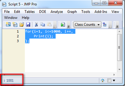

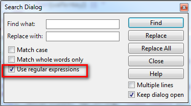

You can use regular expressions in the find/replace window.  2-4 are available in debug mode.  I think the debug mode isn't very user friendly, but it's all available.  Also, for 4) if you hover over a variable while a script is running, it will display the variable value in the lower right.  In debugger you have a locals window.
Regular Expressions:

Hover Display:
