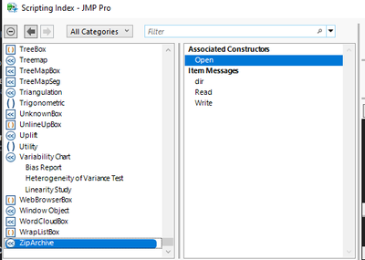

Scripting Index seems to have also documentation on ZipArchive:
