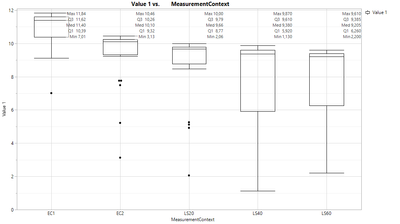

get values of 5 number summary from boxplot graph in graph builder
Hey JMP-community,
I need help with a JSL script. I would like to work with multible values from the "5 number summary" of boxplot graphs in the graph builder. Do you know how to get these values - f.e. in a list or a matrix? to work with these after the graph is build?
BR and thank you in advance

Re: get values of 5 number summary from boxplot graph in graph builder
Thanks alot for you reply, that did in fact help me. I have just one open question left: When I create the distribution all values from all Boxes are put together. Is there an option to create the distribution for different X values? I try to explain it in my example above your post. There are 5 Boxes for different x values (here EC1, EC2, LS20,...) Is it possible to create these distributions for each different X value?
BR
