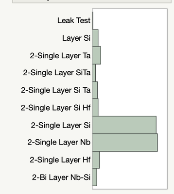

Here I am looking at the distribution of some variables and splitting them by recipe.  I have hidden and excluded some data in the table and if I do distribution of the grouping variable I get 10 levels.

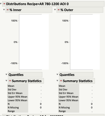

Now I want to look at a couple variables grouped by this variable and I do a distribution set the y variables and then set recipe as the by variable.
What I get is ALL the possible recipe settings ~140+ of them and most with no data as shown below.  It was my recollection that JMP filtered out the graphs with no data and didn't shown them.  My expectation was 10 sets of graphs with only from the rows that were not excluded.

I have excluded them.  I first matched to recipes of interest, inverted selection and hide and exclude.  Here is another example were there is no data for the graph since the points have been exclude.
