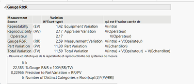

Hi,
I'm starting with gage RR.
Why have I 2,59 and not 3,59 for the measurement variation?
regards
Re: gage RR
The variances are additive, but the standard deviations (reporter) are not: Sqrt( 1.42^2 + 2.17^2 ) = 2.59.

thanks.
