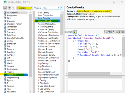

On the numerator, it is the Cauch(0, gamma) density function, in your case. Find it in the JMP scripting index:

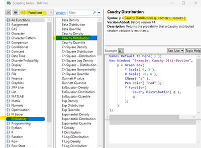

On the denominator, F function is the Cauchy(0, gamma) distribution, in your case. Find it in the index:

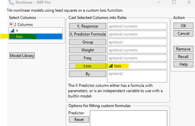

Name the new column "loss". And configure Nonlinear launch dialog. Click "OK".

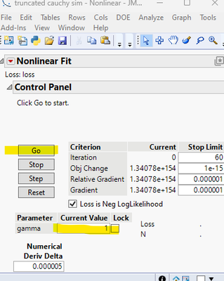

After launching, you can click "Go", or change the value of "gamma" then click "Go". If failed, you can change "gamma" and click "Go" again.
