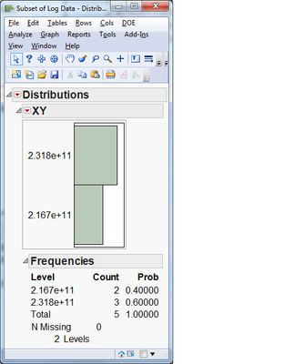

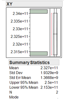

dealing with the mode i came across two issues that look like faults of the JMP program.
1. if there is only one observation the distribution platform does not provide a mode at all. Furthermore, in case of tied frequency of 1 nothing is returned either. this means that the definition in the help file is incorrect when it clams to bring the lower value among the most frequent.
2. when producing a Frequencies table for the column width is long (i.e. 12) making a data table does not allow for recovering the whole number. for some reason it produces a text string of the abbreviated number.

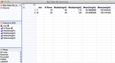

Not sure if this is helpful but on the JMP File Exchange Brady Brady has posted an add-in that gives extended summary statistics capability including the Mode.
http://support.sas.com/demosdownloads/downarea_t4.jsp?productID=111731&jmpflag=Y
5688_Screen Shot 2014-03-12 at 3.30.34 PM.png5688_Screen Shot 2014-03-12 at 3.30.34 PM.png
ron_horne
Super User (Alumni)
Re: finding the mode
Thank you LouV
this is defiantly useful yet not perfect.
Brady's Add-in is only accessible by the GUI and not by script - if it is please let me know.
the N Rows column that shows up is the number of occurrences in each Group and not the frequency of the mode itself. further more i didn't see built in option to get that frequency - if there is please let me know.
otherwise it is powerful and scalable. Brady's add-in aught to be part of the program and not a patch.
Hi Ron,
I believe that the reason JMP reports no mode when a) only one observation exists and 2) when all observations occur only once is that each of these is consistent with the way the mode is defined in many textbooks. i.e., if no element appears more than once, no mode exists.
Cheers,
Brady

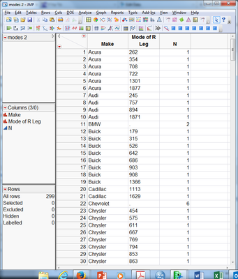

This way is actually more "honest" than other alternatives mentioned in this discussion since it also assesses the frequency of missing data. for example, running the following script returns some missing values as the mode.
dt = open ("$SAMPLE_DATA\Cars.jmp");
mode_by_groups = Function( {collist}, // list of column names
  // Find mode of last column in collist
  Summarize( g = by( Eval( collist ) ), n = Count() );
  X = Design( g[1] ) :* n;
  i = Loc( V Max( Transpose( X == Repeat( V Max( X ), N Row( n ) ) ) ) );
  //Add grouping columns to new table
  dt11 = New Table( "modes" );
  For( k = 1, k <= N Items( collist ) - 1, k++,
  dt11 << (New Column( char(collist), Character, set values( g ) ));
  //Add Mode and N
  dt11 << New Column( "Mode of " || char(collist), Character, set values( g ) );
  dt11 << New Column( "N", set values( n ) );
mode_by_groups( {Make , R Leg } );
