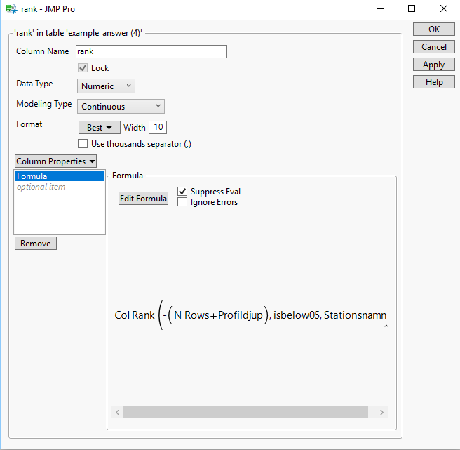

I have not sure what is causing your issue.  When I open the data table you supplied in your last response, I see the you issue.  I was able to correct the issue by Right Clicking on the column header for Rank, and selecting Column Info.  It brings up the Column Info window.  Select "Suppress Eval" as shown below, and then Click on the "Apply" button.  Unselect the "Suppress Eval" and then Click on the "Apply" button again, and see if it corrected the values in the column

Thanks for the ideas, the "suppress eval" selecteing and deselcting helped. However, the wait 5 did not change anything!
