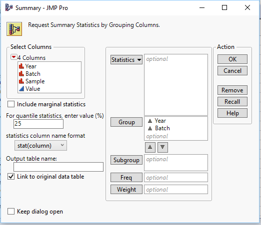

3. Fill in the dialog box to look like:

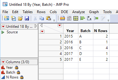

4. Click on OK and it will produce a new data table that looks like

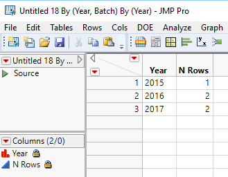

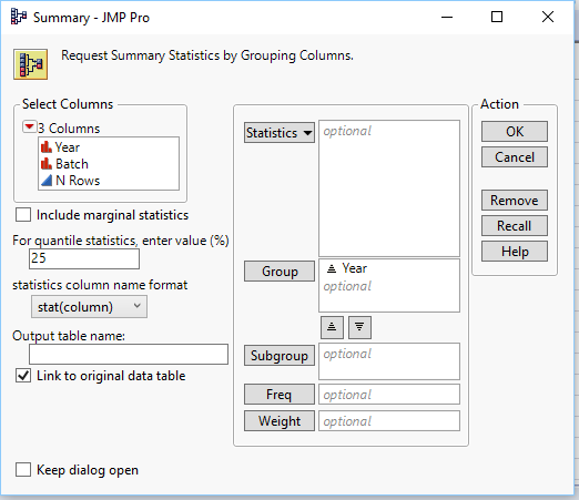

The data in this table contains a count of the count(N Rows) of each different type of batches per year, and you want the number of batches per year.  So If you run the Summary Platform on the above new data table,
You will get the following data table, which are the values you want

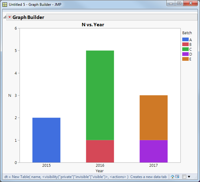

Here's a similar approach that uses the Tabulate platform.
dt = New Table( "Untitled", Add Rows( 10 ),
	New Column( "Year", Numeric, "Ordinal", Format( "Best", 12 ),
		Set Values( [2015, 2015, 2016, 2016, 2016, 2016, 2016, 2017, 2017, 2017] ) ),
	New Column( "Batch", Character( 16 ), "Nominal",
		Set Values( {"A", "A", "B", "C", "C", "C", "C", "D", "E", "E"} ) ),
	New Column( "Sample", Character( 16 ), "Nominal",
		Set Values( {"A1", "A2", "B1", "C1", "C2", "C3", "C4", "D1", "E1", "E2"} ) ),
	New Column( "Value", Numeric, "Continuous", Format( "Best", 12 ),
		Set Values( [2, 5, 3, 8, 1, 2, 10, 0, 5, 6] ) )
dt_tab = (dt << Tabulate(
	Show Control Panel( 0 ),
	Add Table( Row Table( Grouping Columns( :Year, :Batch ) ) )
)) << Make Into Data Table;
dt_tab << Graph Builder(
	Variables( X( :Year ), Y( :N ), Overlay( :Batch ) ),
	Elements( Bar( X, Y, Legend( 9 ), Bar Style( "Stacked" ) ) )
