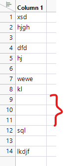

Hi,
is there a way to find continuous empty rows like below? is there any function in JMP that can quickly finding specific number of continuous empty rows? example in picture. in the same column there is multiple rows that is empty but I only interested with the 3 continuous rows that is empty.

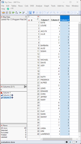

I did this by adding 2 formula columns, Column 2 and Column 3
Column 2's formula is
As Constant( count = 0 );
If( Is Missing( :Column 1 ) == 1 & Is Missing( Lag( :Column 1 ) ) == 0,
	count
If( Is Missing( :Column 1 ) == 0,
	count
and Column 3's formula is
If( Col Number( :Column 2, :Column 2 ) == 3,
	3,

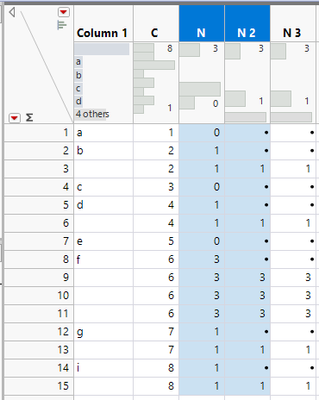

Matrix operations can also be used for this, but usually it isn't necessary and you can just use formulas. txnelson provided one very easy to understand version, here is other version
Column C
Col Cumulative Sum(!IsMissing(:Column 1)))
Column N
Col N Missing(:Column 1, :C))
or
If(IsMissing(:Column 1), Col N Missing(:Column 1, :C),.))
Can combine these into single one, but these tend to be difficult to understand
If(Is Missing(:Column 1),
	Col N Missing(:Column 1, Col Cumulative Sum(!Is Missing(:Column 1)))
