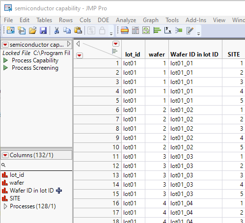

aprilmayjune
Level II
Re: extracting month
Here is a screenshot of the data table. Thank you for looking into this! @txnelson
txnelson
Your column is a character column, not a JMP numeric date column.  To create a column that has just the month part of the character string, use the formula
substr( :"Month-Year"n, 1, 3 );
The structure I used gives the same results as :Name("Month-Year), but the structure I used is the supported structure moving forward
P.S.  In the future when you provide an image of a data table, please provide the left hand panels of the data table.  They provide more detail about the columns.
