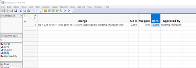

Hello JMP User,
I want to write a script to extract some particular information such Alc%, VA, RS% from :merge and put them in a separate columns. Alc, VA and gravity values are randomly distributed, therefore Recode column would worked iin this case
Any suggestions will be highly appreciated,

Here is an example script that should get you going with solving your problem.  All of the functions used in the script are documented with examples in the Scripting Index, available under the Help pull down menu
Names Default To Here( 1 );
dt = Current Data Table();
For Each Row(
	If( Contains( :merge, "Alc =" ),
		:Alc % = Num( Word( 2, Substr( :merge, Contains( :merge, "Alc =" ) ), "=%" ) ) / 100
	If( Contains( :merge, "Rs =" ),
		:Rs % = Num( Word( 2, Substr( :merge, Contains( :merge, "Rs =" ) ), "=%" ) ) / 100
	If( Contains( :merge, "VA =" ),
		:VA ppm = Num( Word( 2, Substr( :merge, Contains( :merge, "VA =" ) ), "=p" ) )
	If( Contains( :merge, "Approved" ),
		:Approved By = Word( 3, Substr( :merge, Contains( :merge, "Approved" ) ), " :" )
Jim

Many thanks  txnelson,
Your suggestion is working for me.
