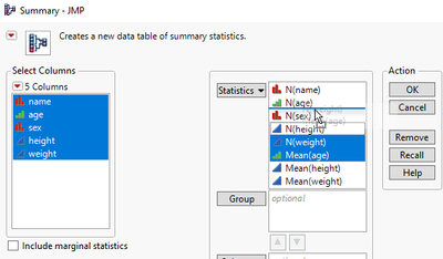

In JMP 16, in the summary table window, one can drag and drop entries in the "group" list to change the order of the entries.
But drag and drop does not work for entries in "Statistics" list.
In JMP17, one can als drag and drop entries in the statistics list, but the effect is unexpected:
Instead of changing the order, the dragged items get deleted.
Is this behaviour intended?
To detele an entry, one could just double click on the entry (like in JMP 16).

That's probably a bug.
Report it to Tech Support ([email protected]) and they'll let development know.

 Thank you for reporting this! I can confirm it is a bug, and the Development team has already fixed it for the next maintenance release of JMP 17.
