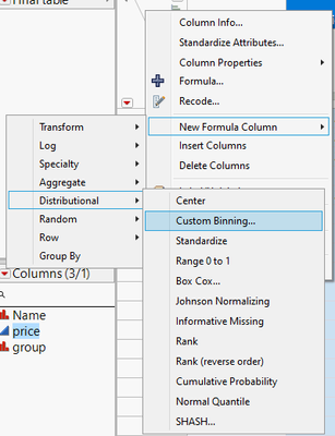

Re: JSL scripting

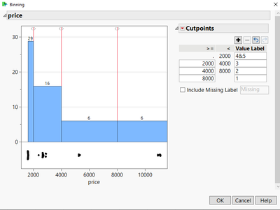

If manual grouping is OK for you, you can use:
Right-Click on the price column/New Formula column/Distributional/Custom binning ...

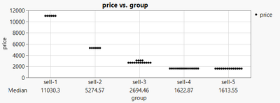

Group 4 and 5 look quite the same. Possible to combine them in one group?
And perhaps split group 3?
