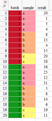

Is there a simple way to  calculate the cumulative sum when there is a group and subgroup that are to be cumulative sum. Shown in the following picture, I want to calculate cumulative sum for batch 1 and all sample a, then batch 1 and all sample b and then batch 1 and all sample c.

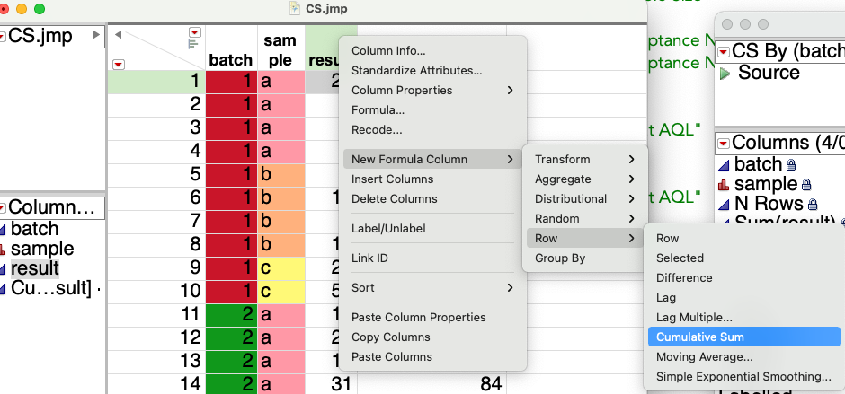

You can add a right-click formula column for cumulative sum.
Right-Click on a column and choose New Formula Column.
Choose Row--Cumulative Sum
JMP New Formula ColumnJMP New Formula ColumnEdit formula to add by variable using "^" insertEdit formula to add by variable using "^" insert

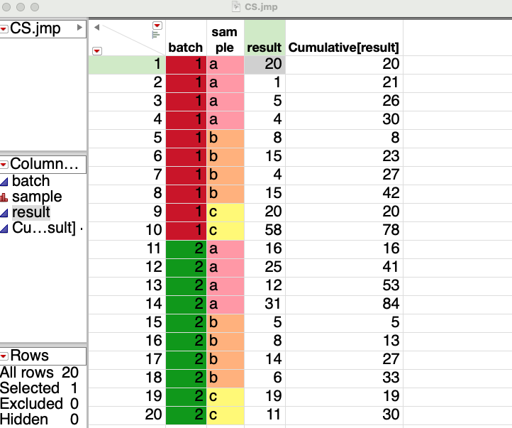

This will calculate the cumulative sum as shown in the image below.
Cumulative Sum with By variableCumulative Sum with By variable
I have attached a modified version of your data table with the included column formula.
