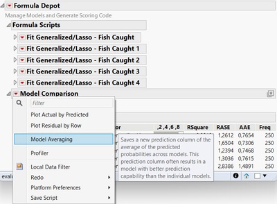

  3. Create model averaging of your K models : This is my preferred approach (if possible). Once you have your K models, you can run each model and save their prediction formula using "Publish Prediction Formula" to store your models in the Formula Depot
    Once the models formula in the Formula depot, you can click on the red triangle next to "Formula Depot" and select "Model Comparison". This will create a short summary of the performances of your model, and if you click on the red triangle next to "Model Comparison", you can create a Model Averaging :

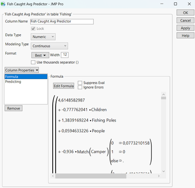

    This option will create a new formula in your datatable, that corresponds to the average equation of your K models (in my case, the average equation/model of my 5 individual crossvalidated models) :
    You can then compare once again the performances of your K individual models and your average model using the same Model Comparison platform.
