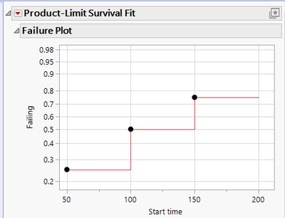

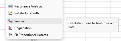

Please have a look at Analyze/Survival:

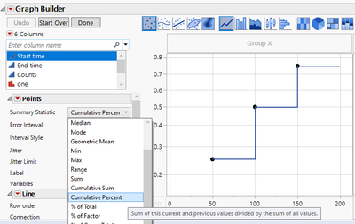

As an alternative, you can use GraphBuilder. In the Summary Statistics menu you can find "Cumulative Percent" - which uses the Kaplan-Meier definition to calculate the probability. With a trick *), you can even use it for points [fromAdd CDFs to Graph Builder]:
Please note:
for i/N, the last points has a probability of 1 ... and gets lost when probability scales are used on the Y axis - like in the plots in this post. This is why I submitted a wish to add alternative probability functions as an option in Graph Builder:Summary Statistics in Graph Builder - add Cumulative Probability
