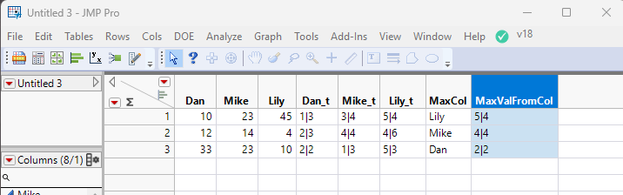

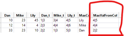

Hi,
I have data similar to example in picture. first 6 columns are related. I created MaxCol to find out who has the Max which based on first 3 columns, then I want to create MaxValFromCol column where it take value from one of the column from 4-6. it will pick value from column 4-6 based on MaxCol. I tried to set the value of MaxValFromCol using Column(char(:MaxCol) || "_t"), but not success. Can someone give some suggestion how we can take a column value as column name and set value based on it?

I able to get the MaxCol What I want the MaxValFromCol to be is the value from column 4-6, not the column name. For example, row 1 i MaxCol =="Lily", then the row 1 of MaxValFromCol will take value from Lily_t, which is 4|5. the Row 2 is 4|4 because row 2 of MaxCol is Mike, so that 4|4 come from Mike_t

As Column(Column(:Column 1 ||"_t"))
You can also most likely drop the Column()
As Column(:Column 1 || "_t")
