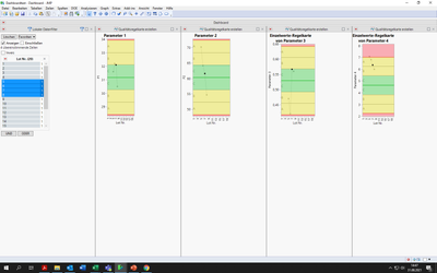

create Dashboard with fixed windows for all graphs inside the dashboard
Hello!
I built some dashboards with control charts inside but whenever I open them, they usually look different in terms of that the windows for each of my parameters are smaller or larger each time I open them. How do I set the windows for each parameter to a defined size so I do not have to adjust the whole dashboard each time I like to present it?

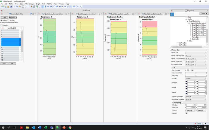

sorry for my late reply, but I tried and actually found the properties of my graph inside the dashboard.
right click on the first graph and using show properties helped.
I tried different settings in the menu point "stretching" for the graphs but It does not seem to work the way I want it. I can not change the parameter for Min or Max size under stretching.
I tried to change the stretching parameters for the frame box of my graph to "fill" or "window" but that really did not help.
My understanding is that setting the other boxes to neutral will make them change when a box inside changes, so just changing the properties of the frame box should change everything else or does it not? So on which level do I need to change the parameters to make a graph that uses just the amount of space that I like it to have when opening the dashboard in a full windows. That is my question.

I cannot tell from your picture if you are viewing the Properties panel in the dashboard or in the Application Builder. It might make a difference.
I understand in principle what needs to be done but I am not sure about the details. The display tree can be very complex and the relationship between parent, child, and sibling display boxes can be complicated. Perhaps another Community member knows the specific changes that would help. Otherwise, I would contact JMP Technical Support (support@jmp.com) for help.

I used the properties panel of the dashboard. I am still trying to understand the application builder as I do not know how to use it or open an existing dashboard within the application builder. But yes it is a complex display tree in which I try to understand the relationships. In the dashboard properties I tried to change the stretching of the frame box from Min Size x = 30 to Max Size x = 3000000 to different values, but that did not work. Whenever I wrote another number into that field and pressed enter it just changed back to the old setting. I built a new dashboard with the application builder as I do not know how to open my existing dashboard in the application builder and right now I am trying to find the right properties panels to change things. But so fare I did not succeed. So there is no one-page help file for this I guess?

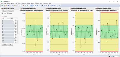

I usually have built my "dashboards" with New Window. The example below can give you some ideas (you could possibly also use Dashboard builder instead of new window, if you figure out how to reports there).
Create a function (or expression) to build your control charts with fixed size (or size as argument) and then use that function to build the dashboard you want.
Names Default To Here(1);
dt = Open("$SAMPLE_DATA/Semiconductor Capability.jmp");
build_cc = function({colRef}, {cc},
	cc = Eval(EvalExpr(dt << Control Chart Builder(
		Size(250, 500),
		Show Two Shewhart Charts(0),
		Show Control Panel(0),
		Show Limit Summaries(0),
		Variables(Subgroup(:wafer), Y(Expr(colRef))),
		Chart(
			Points(Statistic("Average")),
			Limits(Sigma("Moving Range"), Zones(1), Shade Zones(1))
		SendToReport(Dispatch({}, Expr(colRef || "Limit Summaries"), OutlineBox, {Close(1)}))
	return(cc);
New Window("",
	Data Filter Context Box(
		H List Box(
			dt << Data Filter(Local, Add Filter(columns(:Wafer))),
			build_cc("NPN1"),
			build_cc("PNP1"),
			build_cc("ESP1"),
			build_cc("EP2")
-Jarmo
