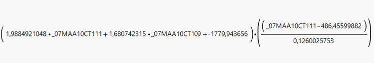

In articles, for t2 contributions using formula (X-colMean(X))/std.dev. But in Column Formula of T2 variable contribution, saved from Model Driven Multivariate Control Chart(JMP 16), we can see multiplier before (X-colMean(X))/std.dev. For Example:
What is this?
1.98849210478157 * :_07MAA10CT111 + 1.68074231499255 * :_07MAA10CT109 + (-1779.94365628861)

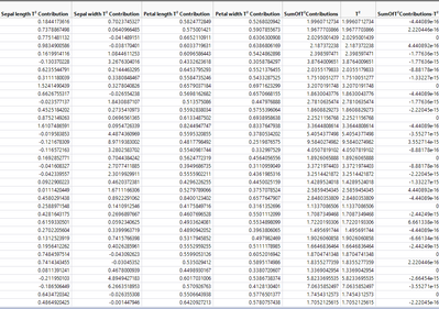

My guess is that you have a contribution formula for one of the variables you have. I think you sum all of the contribution formulas together you should end up with the T2 (or very close to it).
Using Iris.jmp as example:
