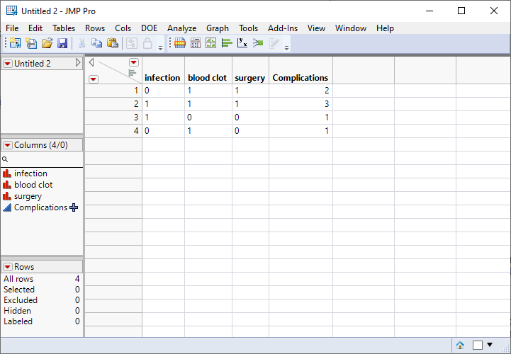

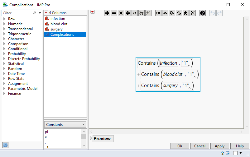

Re: counting character columns in jsl
A formula is all you need.
Here is the result.
