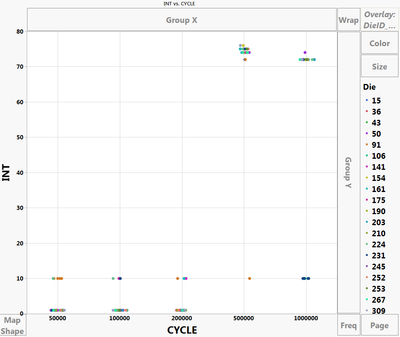

What is the best way to count few data values which are above a certain value?
Attached is the figure. In the figure I want to have the count of 500,000 and 1,000,000 cycle which are in the 70's, not the ones below 10.
Thanks,

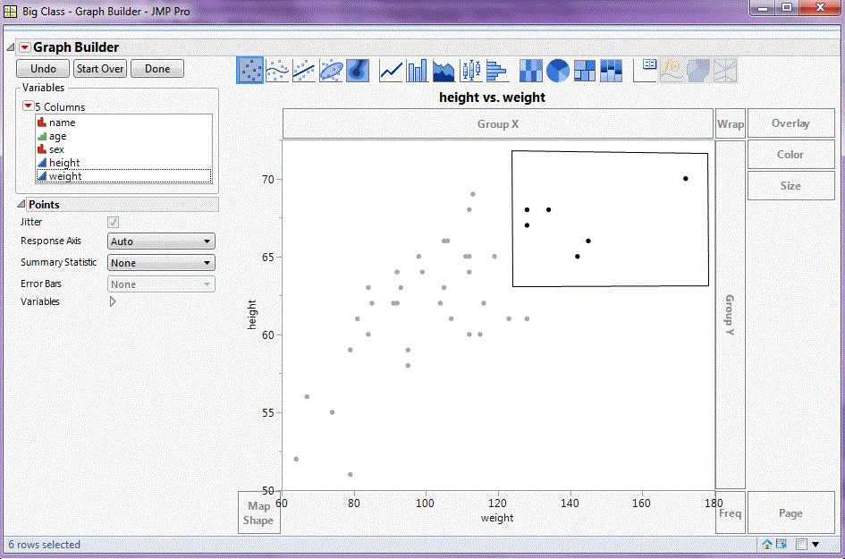

To find out the number of data points anywhere on the chart, all you have to do is to select the data points you want to count, by selecting them in the graph, and then looking in the data table in the row panel section, and it will tell you the number of data points selected.
Jim
