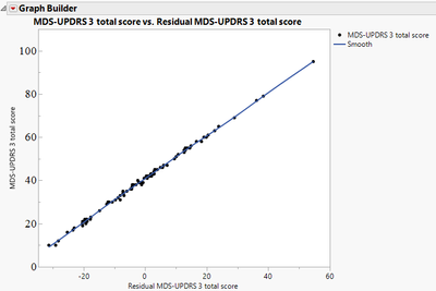

One possibility is to regress biomarker X on age and gender, save the residuals and then plot them against motor severity score Y in graph builder as a simple scatterplot. This is what that looks like with the data you provided,
Another possibility, for treating age and sex as covariates, is to do a hierarchical regression. In other words, you can fit a regression model where age and sex predict your outcome, then fit another regression model where age, sex, and biomarker X predict your outcome. You'll obtain the R-squared for each of those models (turns out it's .002 and .11, respectively). You can then look at the "Sequential Tests" (or Type I Sum of Squares) of the effects to obtain a test for the change in explained variance from one model to the next. In this case, the change is statistically significant with an F-value of 11.23, p = .001.
I saved the scripts of each of these steps in the attached data table.
