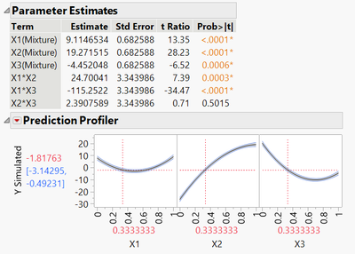

Here is a simple example:
Notice that X1*X2 and X1*X3 are significant "interactions". Those are actually quadratic terms as evidenced by the curves in the Prediction Profiler.
To understand why you need to understand how the Scheffe mixture model is reparameterized due to the mixture constraint. X1*X1 is rewritten as X1*(1-X2-X3) for a 3 component blend. That results in "additional terms" for X1, X1*X2, and X1*X3.
