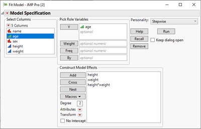

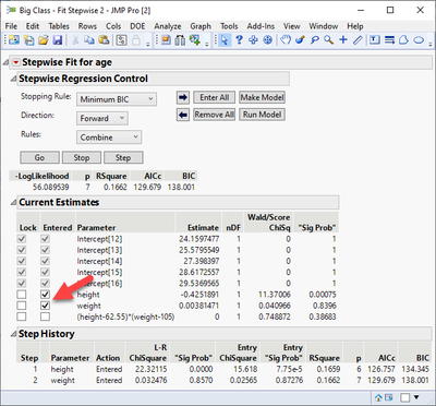

Instead of adding variables in blocks, you can add them individually in any order and just stop after adding each block.  Using fit model add all of the possible terms in every group as model effects. For example, if you want to predict age in the big class data set from height and weight and then decide if you should add the height*weight term, you would add all three terms in the model launch dialog box.  Then enter the terms in your first block, record model fit parameter's, and then add your second block and compare.  It is possible that you can use the settings in the Stepwise Regression Control section to automatically get you to the model you would have chosen yourself.
In Fit Model launch add all model effects and select stepwise:
Add the first block's variables (I am ignoring the P value for weight):
Now add the second block and notice how the RSquare went up slightly, but so did the AIC and BIC, likely indicating that you would not want to include the second block.

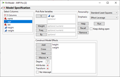

Build a model using the first block:  Here I converted age to continuous to make the example simpler.

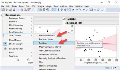

Save the predictions and the residuals:

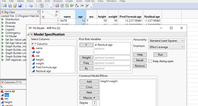

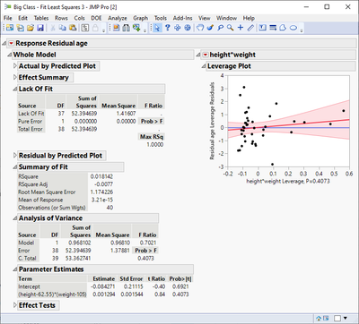

Now launch fit model again and predict the residual from the first model using the second block, remember that neither of these needed to be linear models. You might get a message that you are missing an effect because JMP (correctly) doesn't want to build a model from the cross term without each individual term.  In this example they were already included in the previous step but you could add it again.
Now you can use the results in this model to decide whether to include the second block in your final model. In this case the p value for both terms is very high, indicating that you should not include block 2.

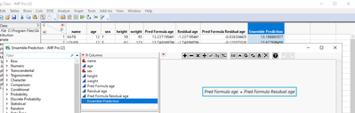

To get the prediction using both models, just add the predictions from each:

You do not have to click Go or Step in the Stepwise platform and use the automated model selection approach that you wish to avoid. You can specify all the terms in the full model using the Analyze > Fit Model launch dialog and then add them in Stepwise in groups as you deem suitable from a priori knowledge. That is to say, you can identify blocks by the terms that you enter together. The history section allows you to select any previous model using a radio button and it returns to that model. Some information that you want, e.g., change in R square, is not directly available.
